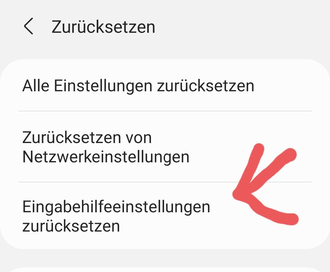

So ever since the last update the physical keyboard layout has switche and the keys for ü, ä and ö now print out [, ' and ; instead.
I tried to change every kind of laguage setting which could have an effect on this but it didn't change anything.
Then after some research I Found that reseting the tablet worked for someone so I backed up my data and tried and at first it worked.
Yet after restoring my data, apps and so on the problem has now returned.
there are also other keys that print out the wrong symbols, letters or numbers. Gelöst! L: Gehe zu Lösung.
    There was a solution to this some time ago. In the settings, general administration, reset, there is the setting > input help reset. This reset eliminated the error. See the screenshot..
    If you run a complete Reset of your Device, the Book Cover Keyboard must be conncted to your Tablet. This is the other way to solve this problem.
    I marked L: @USflatliners answer as "solution". *:smiling-face:
